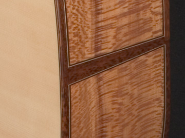

I'm pretty sure the looks are the kicker here. I'd like to see a back and side set but I'm pretty sure the darn trees don't grow that big. Here's a snakewood bound guitar I did with sycamore. I think it worked pretty well.

[QUOTE=Pwoolson]Here's a snakewood bound guitar I did with sycamore. I think it worked pretty well.
I disagree...I think it worked very well.
PostPosted: Wed Aug 10, 2005 5:24 am
Me too
